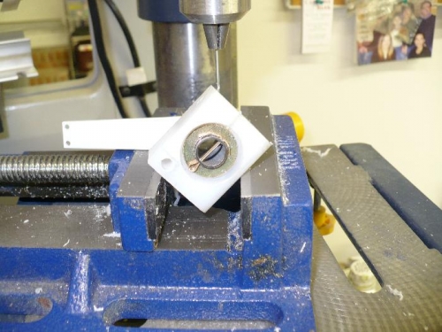

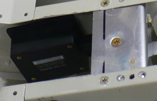

Today was spent installing the aileron trim servo and wiring to relay board and indicator. I drilled out two center cover plate nuts and installed them in the servo pivot arm bracket. I cut the pivot arm and drilled for the cotter pin. I bent the servo pivot arm per th eplans for a RV 7 and mounted the bracket and servo motor. The servo motor was the greates challenge as my angle drill and bit would not fit between the formers. So I cut a drill bit down in order to drill the mounting holes.
Pivot arm cotter key
Bracket mounted
Bracket mounted
Bottom screws were .....
