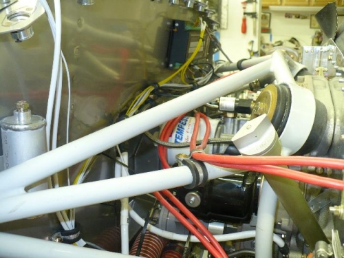

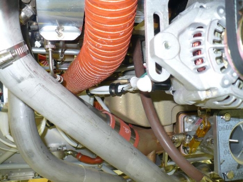

Brief Description:  Engine compartment wiring
I spent the first two hours cleaning up my receipts and paper work. One of these days I'll figure how much this plane costs:) I cut apart the Harness sent by Van's since I have 2 batteries and a different location of the circuit breakers and switches.
I wired the alternator and master relay coils. I wired the magnetos and changed out the adel clamps for the proper size. It's getting harder to work around the engine with all the heater hoses, spark plug wires etc.
Adel clamps hold wiring off metal
Alternator and starter wiring
