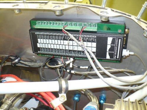

Brief Description:  Engine compartment wiring
I finally got some K thermocouple wire so I can now connect the EGT sensors to the BMA engine pod. I've ditched the automobile style connectors and soldered and heat shrinked the thermocouple wires. I got 3 conductor shielded wire from Sparkchasers so I made the extension cable for the fuel flow sensor.
BMA engine mod
BMA engine mod
