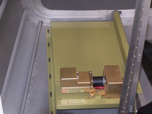

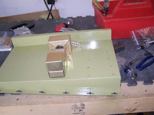

I've been anxious to get the autopilot servo mounting behind me. The aileron servo just does fit. I added a double under it as there is really very little room for the servo under the floor access panel. I will bolt up from the bottom of the fuselage. The same holds trus for the elevator servo tray. I made it removable just in case I every have to change EFIS and autopilot manufacturers.
Aileron servo doubler
Removable elevator servo tray

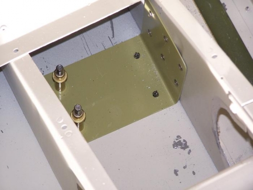

Servo mounts via platenuts
