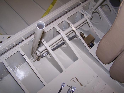

Brief Description:  Servo mounting
I was anxious to work on the aileron servo mounting. I had thought it was going into the wing but after talking with Greg at BMA I decided to try and fit it under the floor pan as he suggested. I ordered enough parts from Van's to put it in either place. As it turns out, it will just fit under the floor board. I'll need to find a tap to retap the hexagonal bar that I cut to fit and I will have to add a doubler to the floor skin. It really cuts down on the wiring from the controller to the servo.
Fits snuggly under the seat
Shortened hexagonal rod
No binding with full stick motion
