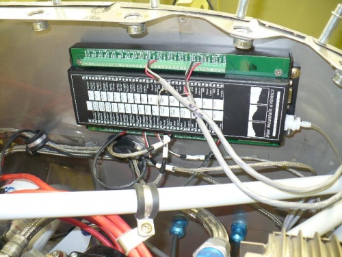

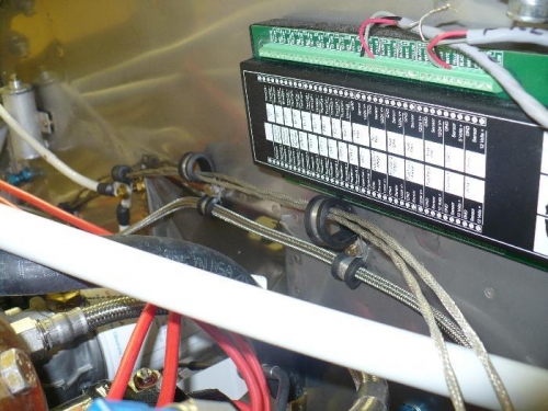

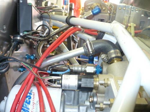

Today, I'm working on wiring the engine sensors to the BMA engine module. The CHT sensors are too long and shielded with braided wire. I do not want large coils of excess wire so I shortened their length to fit and then put new heat shrink over the shield. I'm also trying to put enough adel clamps in place to hold the wiring.
Long CHT sensor wires
Installing adel clamps
Tying off wiring
Tying off wiring
