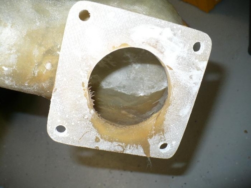

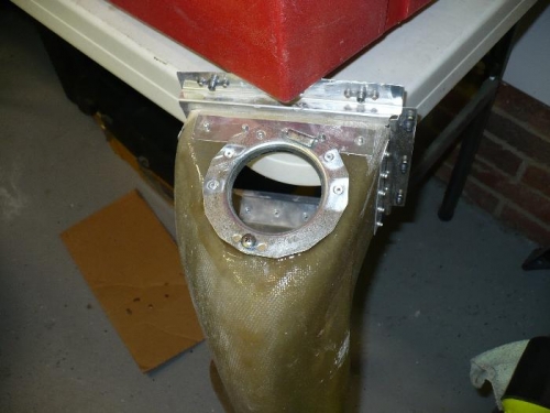

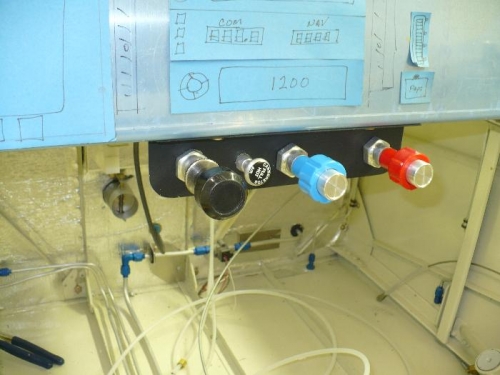

Sump is done and mailed back to Superior. Now back to moving forward. I'm now working on the alternate air system. The cable I bought for the alternate air does not have enough throw. In order to completely open teh alternate air door, the cable guide comes out too far. Thankfully I have another cable but it's not as attractive as the current one. I also made the decision to move the alternate air control to the front of the panel. It should simplify the emergency procedure for loss of intake air due to icing.
I also added fiberglas to make a smooth transition through the outlet of teh snout. Jeff and I had to move the flange 1/4" in GA for the snout to fit. I re-inforced the flange with a layer of fiberglas on the outside.
Cut hole and fiberglassed  venturi
Fiberglassed out lip
New location, old cable
