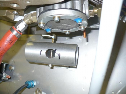

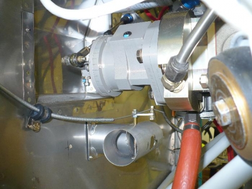

Now that the sump is off, I can get to the mixing box that Jeff talked me into. It needs a bypass hole so that when the cabin heater is off, air can still flow through the heater muffs. I also mounted the heater control cable and started putting the new sump on!!
Bypass hole
Bypass hole
Heater cable, needs smaller adel clamps
