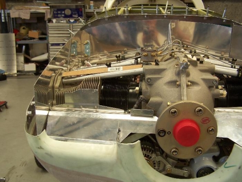

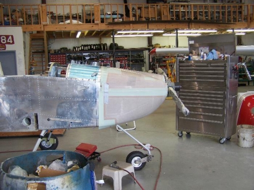

Day 4. I made the backing brackets for the Skybolt fasteners and drilled them. We then prosealed the brackets to the cowl and set them aside to cure out.
I made the heater cable mounting bracket and the alternate air cable mounting bracket and installed them after priming and painting. They even have a paint booth in the hanger! I must be in the airplane builders heaven.
I finished making the extended battery box and Jeff talked me into adding a heat shield to thefirewall inside the cockpit. We made a bracket for the gascolator and mounted that.
Shucks, it's time to take the prop back off and work on the engine. We mounted the govenor and mounted the control cable bracket.
Jeff also talked me into removing the interior aluminum gas lines and replacing them with rubber hoses.
Prop off to work on engine
Both halves fitted up
Skybolt bracket ready to proseal
