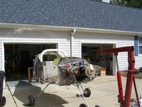

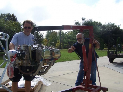

I met Lennie for breakfast at Pollard's and then we finished all the riveting that I couldn't do single handed. We decided that it would be best to move the plane outside to more level ground. It does come out of the garage without hitting the door:) I tried to follow George's directions but we ended up leaving all the bolts loose until time to put in the last one. It just would not go so we tightened the other three which aligned the last enough that we could get it in. We then took one bolt out at a time and installed the correct number of washers and then the cotter key.
After Lennie left, I started cleaning up some loose ends in preparation to going to GA for help with firewall forward work.
Lennie hitching the engine up
Careful now!!
Careful now!!
Engine in place
Engine in place
