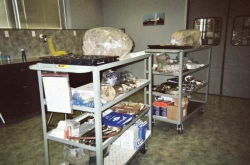

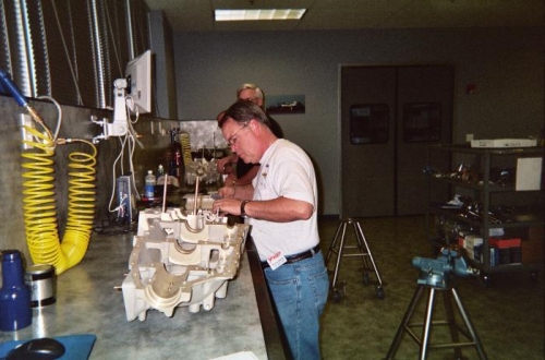

Evan covered what we would be doing in the shop, shop saftey, tools and their proper use. We then proceeded to the shop area to check parts against pick list. Broke for lunch at Bass Pro Shop. Then back to work. We prepared case halves for mating, checked crank thrust tolerances and cam shaft tolerances. Mounted crankshaft to the engine stand. Then applied sealant to case halves as well as one silk thread. We then joined the case haves with the cam shaft and roller lifters. Torgued all bolts and installed the piston rods and bearings. We then quit for the day.
Nothing but parts
Nothing but parts
Inspecting the case
Inspecting the case
