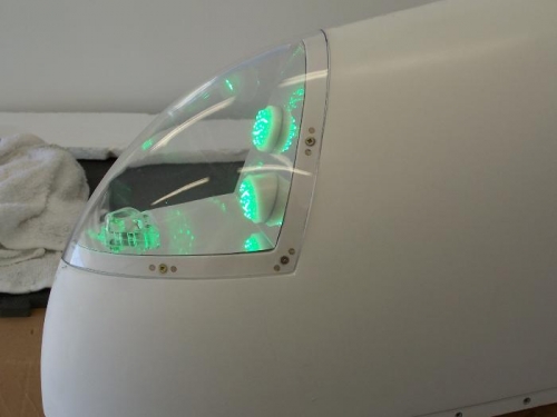

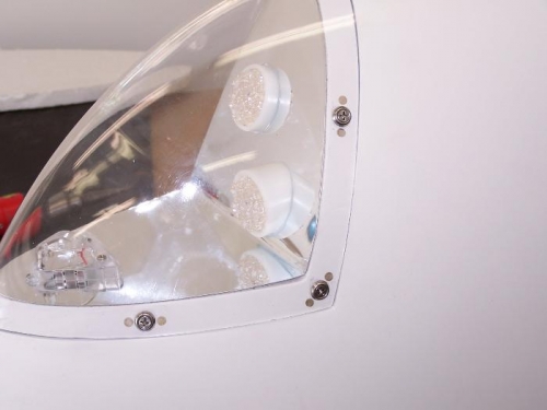

The nutplates finally arrived form Van's. It took two weeks from the date of the order. They came while Vic and I were in TN visiting our son and his family. The wing tip lens puckered when mounted so I picked up stainless steel washers and screws that allow for larger mounting holes. The wingtip lens looks much better.
Pucker gone
Pucker gone
You can see the pucker
