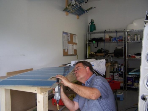

Brief Description:  Install nut plates for access panels
Counter sunk nut plates for wing access panels. Riveted nut plates and clecoed wing panel on. Bottom panels are now ready for riveting. Looking for help with the process. Will call around for help on Monday. Finished cutting spacers for aileron hinges. Installed spacers and nuts. Still need to pick up dowel rod so that I can bend flap just a little more so that it does not scrub as hard.
