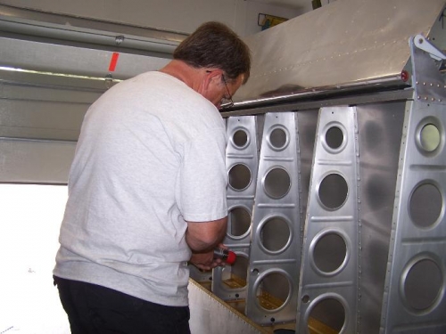

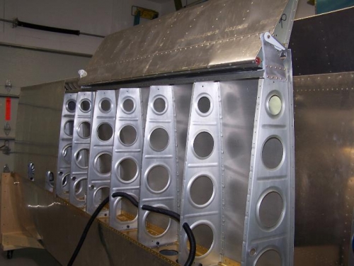

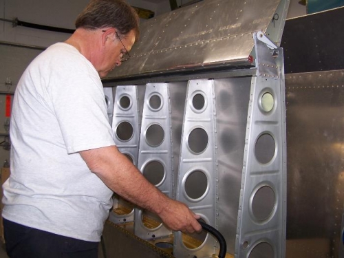

Brief Description:  Drill left wing for wire tubing
After talking with Van's and looking at their FAG's, I decided to drill the wing ribs for the plastic tubing. I went to Lowe's for a drill bit extension. Th eonly one that I could find was for 1/4" maximum shank. The 7/8" unibit is 3/8" so I had to drill it out to accept the unibit. Quite a chore but slow and cool did the trick. Dilled out left wing. Will work on the right later.
