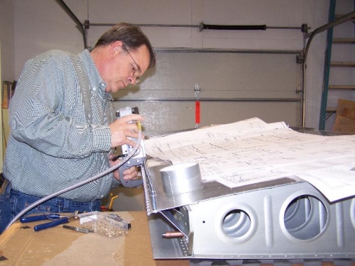

Mounted right aileron and cut bushings for brackets. Align flap and hinge. Marked hinge and removed hinge pin. Drilled hinge, dimpled skin, countersunk hinge and riveted. Terry came over and helped install aileron stop and tank flap.
Riveting Flap hinge

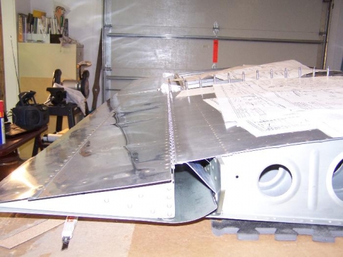

Flap installed on right wing
End view
