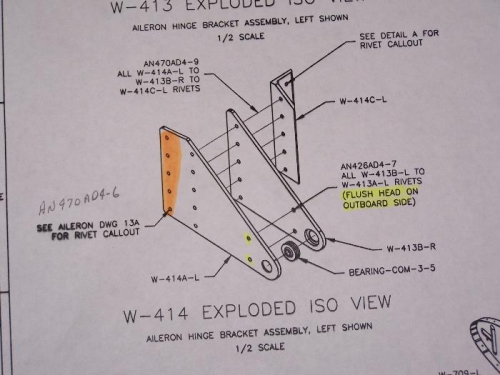

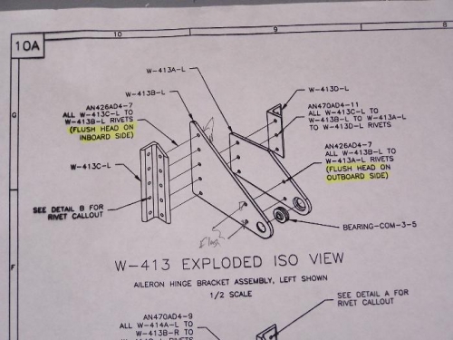

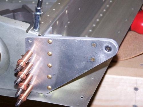

Brief Description:  Rivet aileron hinges
Working on right wing aileron hinges. Squeezer will only reach 3 out 5 rivets so had to get the rivet gun and bucking bar out. Still confused by drawings and Terry concurred with my interpretation but suggested that I email Van's. Took pictures and emailed Van's. Alex and Vero are here so building time is limited this week.
