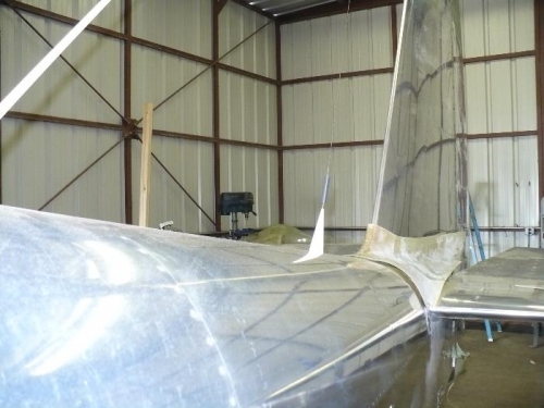

Work on RV with Terry. We mounted the flaps, made the flap connecting rods, installed the flap connecting rods and cut the fuselage for the rods. We made an elt antenna doubler plate, riveted the plate and mounted the elt antenna.

ELT antenna mounted
ELT antenna mounted
