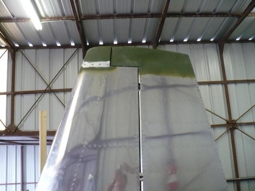

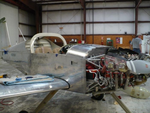

The rudder was scrubbing the vertical stabilizer so I adjusted the eye bolts for clearance. I installed rudder tip and trimmed the wing fairings for a 1/4" gap and drilled and dimpled the holes.
I install the fuel fuel pump and measure for fuel line hoses. Charlie is going to order them.
Adjusted gap and installed tip
Wing root fairings
Wing root fairings
Fairings with gasket
