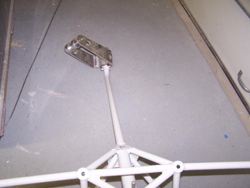

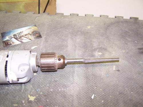

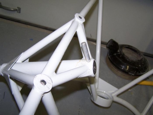

Worked on nose gear fit and got the gear stuck in the motor mount. Thankfully Lennie came by and lent his "weight" to the motor mount so that I could get the gear unstuck. It took more sanding until everything fit. I'm changing the bolt to a taper pin based on what I've read about nose gear failure on teh RVs.
Taper pin instead of bolt
Tapered reamer
Tapered reamer
Fits smoothly now
Fits smoothly now
