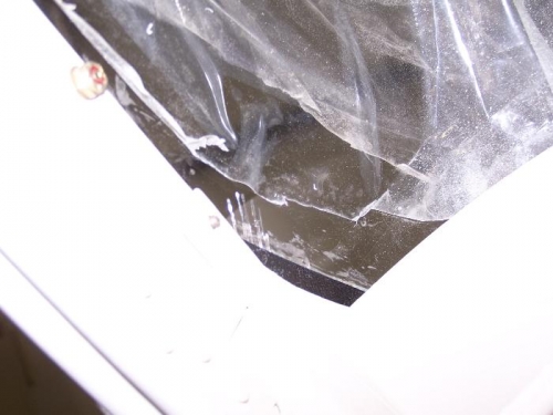

More sanding and fiberglas work on canopy. The canopy has developed some stress cracking. I emailed Van's and the consensus is to not stop drill the stress cracks. They are less than 1/2 inch so I'll monitor them and stop drill if they get longer.
Stress cracks
Both sides of canopy
