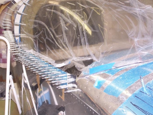

Brief Description:  Canopy
Starting to get there. It looks like I'll have to use clips on the front edge. I've tried everything that I can think of. The sides just bow out to much. I even tried a heat gun to relieve some of the forces. Helped maybe a little. Started installing the side skirts. They seem to want to lift the front edge up so I placed 45 lbs of weight on canopy to hold it down while drilling for screws.
Installing side skirt
