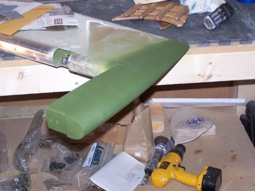

I decided to tackle the fiberglas work so I would not have all of it to do at one time. It also allows me to clear the deck of everything but the fuselage. I trimmed the tips to fit, drilled holes, dimpled and riveted the tips on. Based on the planes we saw at Sun n Fun, I decided to use body putty on the pop rivets. Lots of extra work but I think it looks much better.
Not much clearance for fiberglas

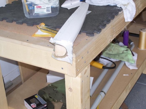

Used balsa for end plate and glassed over
