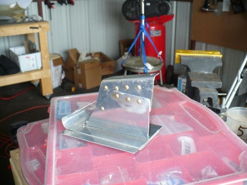

I removed and reworked the lower cowling bracket #$@%&*(. What a pain to work on. I have to glue the nuts in order to get the bolts started.

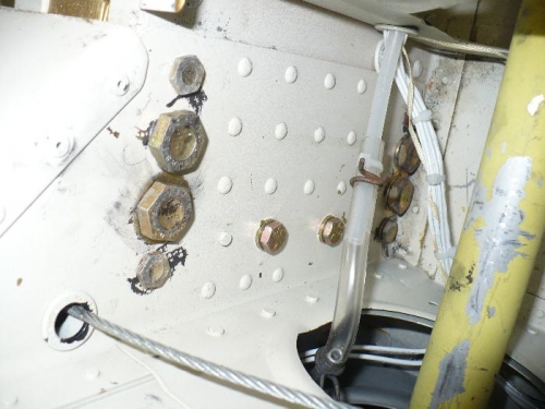

I installed the 4 AN4-13A wing bolts that I missed putting in when we attached the wings.

Cowl seals
Cowl seals

AN4-13A bolts to the right
