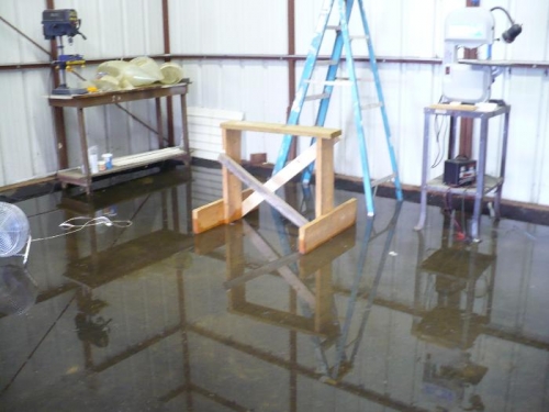

I started the day off with a flooded hanger:( I swept the water out but the humidity was raised in the hanger due to all the water on the floor. I'm working off my finish punch list so I get to do a little here and a little there. First task was connecting the compass light to th edimmer circuit and attaching the molex connector to the canopy frame. Next was installing the screws in the fresh air vents and replacing the instrument panel screws with black screws.

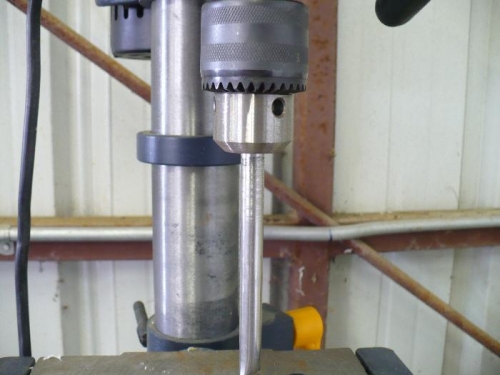

The next task was knurling the ss tubing that is part of the support system for the exhaust. John another RV owner has warned me that the exhaust system will slip down and touch the canopy if the ss tubes are not roughed up.

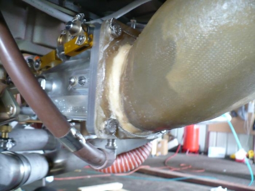

On to the air box mounting bolts. They needed to be safety wired but I had no bolts with holes in the head. Allen and Mike set up their milling machine so that I could add holes to the bolt heads.

Knurl ss rod
Knurl ss rod
Air box safety wired
