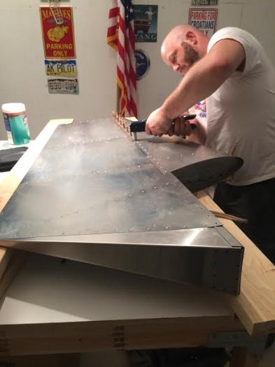

As per the Zenith construction guide all skin was riveted towards the opening side of the skin. Starting at the back and working toward the open end side to prevent oil canning of the skin.
Every other hole
making my way towards the edge
Final Rivets
