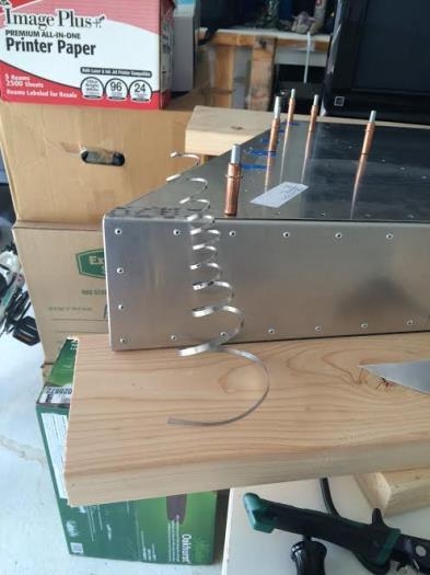

Final fit of the Skin, both the rudder skin and the front nose skin. The Rear skin predrilled from the factory, front nose skin drilled to match rib punches. Final test fitment of skin and trim, deburred and clecoed onto tail spar and ribs. Cotect Primer applied to all parts where two pieces of metal come into contact and left to dry over night before final riveing was conducted.
Cut and Trim to fit rudder rib

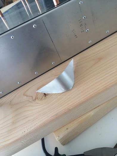

Trim off Rudder Skin
Trim excess off skin
