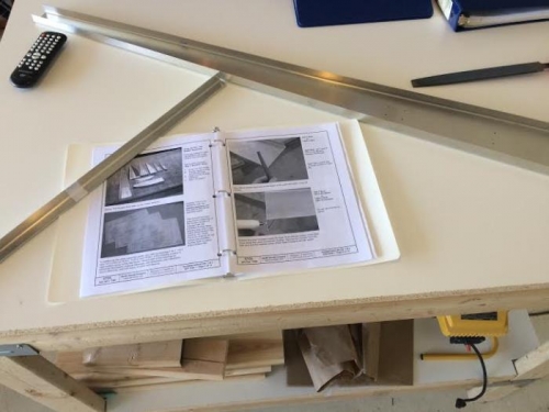

Step one: used a file on all the edges to remove any burs from the CNC machine
Step two: Trimmed the Spar Doubler to match the bottom of the spar, used snips to cut and metal file to deburr the rough edges.
Step3: label the rib stations on the spar.

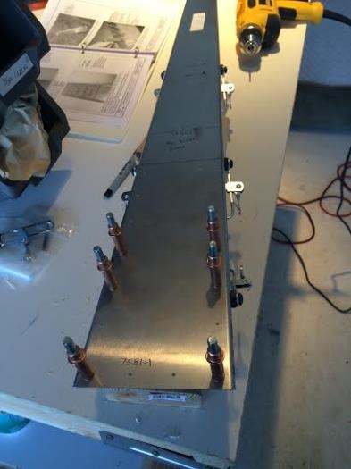

Step 4: Clamped the doublers onto the spar using handi clamps and drilled through predrilled holes on the spar into the doublers. Clecoed into place.

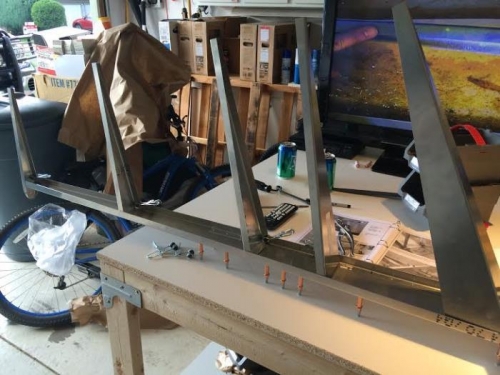

Step 7: Drilled each rib to final size into the spar and deburred.

Drilling the Doublers to the Spar
Drilling the ribs to the spar (tail)
