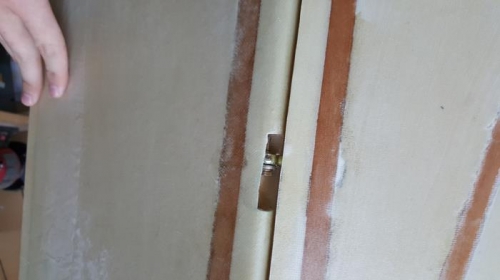

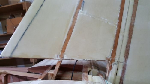

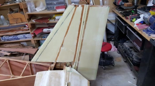

Brief Description:  Vertical stab glassed
-Installed VHF antenna kit from RST engineering on foreward spar
-Hot glued in foam and sanded to contour
-Glassed with one layer on KR cloth on each side overlapping at leading edge and one layer of 1.8 oz cloth over everything.
-Glassed gap seal after stab cured
