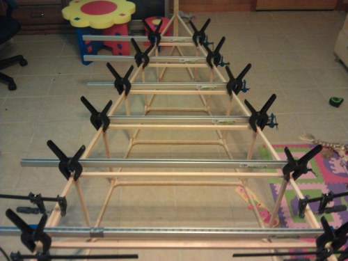

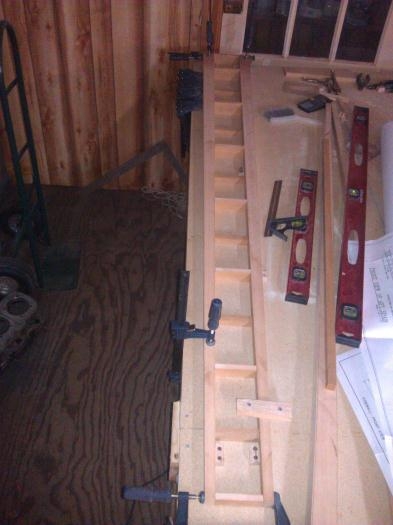

Brief Description:  Upper cross members and front outer spar
Today I glued in the upper cross members. This time I glued them without the gussets and used spring clamps at the front so they would not slide forward when I clamped them with the bar clamps. This made it so much easier. Then I started cutting the verticals for my first front outer spar
