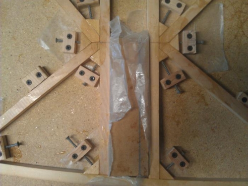

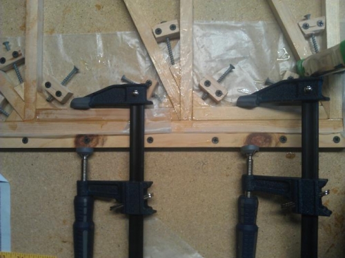

Brief Description:  Gluing first side

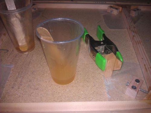

I spent time cleaning up the shop and everything on the table before gluing. All of the jigs were loosened up and then I slid wax paper underneath. I am using T-88 for all of my wood gluing. After everything was glued and clamped back down, I verified all measurements and also glued together two pieces of scrap that I will break apart tomorrow after it cures. This will verify my mixing and hopefully give me some confidence in my work.
scrap piece
scrap piece
