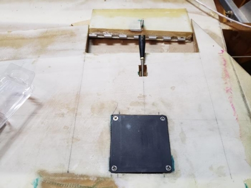

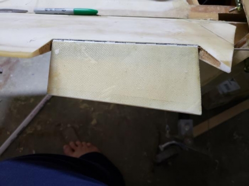

-Spent last couple of days installing the trim tab.
-Floxed in hinges
-Made mounting brackets for trim servo and floxed in
-Made control horn and cut shaft to length
-Misc touch up work on aileron ends, and filler for trim tab

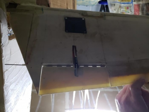

10/17 1.5
Routed trim wiring through elevator
10/18 1
Hooked up trim wiring and calibrated indicator
