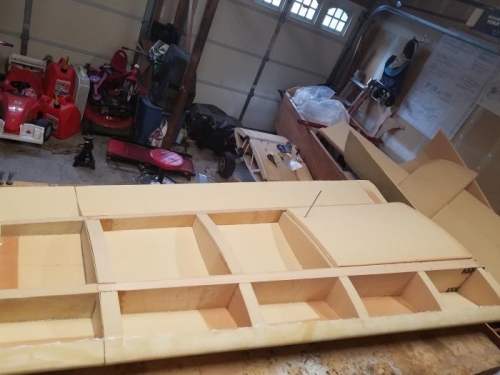

5/19 1.5
- glued leading edge panels and sanded to contour
5/20 3
-finishing leading edge sanding
- patched a couple spots
- Filled and sanded wing gap
- floxed in fuel cap
- cut all of the fiberglass for wing

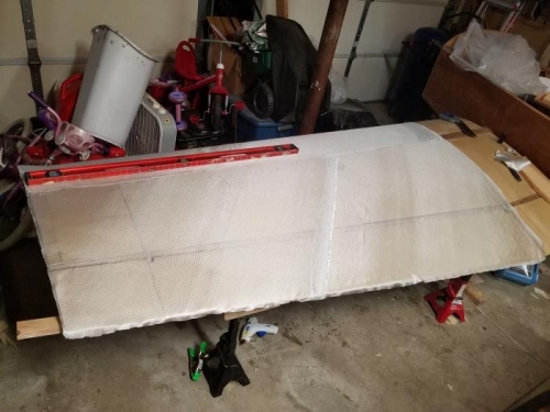

5/21 3 glassed top of wing
5/22 1 marked and cut wing free

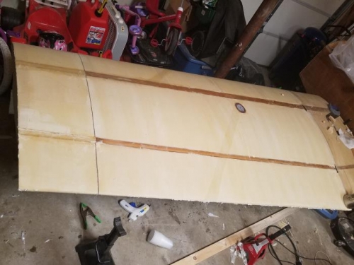

5/23 1 removed wing, installed fuel bracket, and cut vent holes through ribs
5/24 3
Cut and glued in lower wing panels
5/25 2 Flipped fuselage and bolted wing back on
5/26 3 sanded wing to contour and cut fiberglass
5/27 3 glassed lower wing
