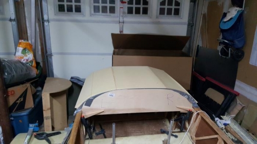

4/23 3 cut left stub trailing edge. Flipped plane upright. Made template for forward deck.
4/24 3 cut, glued and sanded forward deck foam

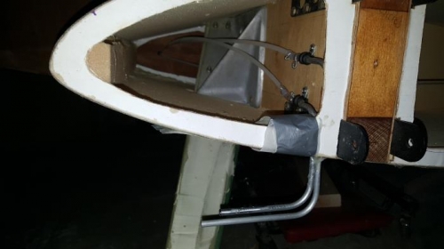

4/25 2 glassed forward deck. Cut and clamped pitot hose
4/26 3 cut and secured piano hinge to forward fuselage. Glassed inside of forward deck and microed onto hinges.
4/27 3 added fiberglass over plywood still on forward deck and re-secured upper hinge.
Sanded and varnished inside fuselage area behind shelf.

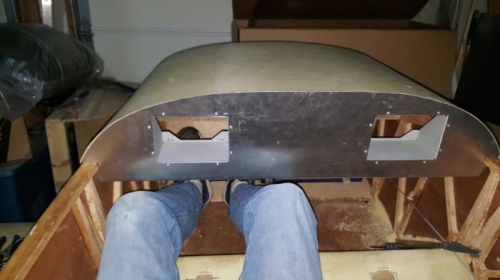

4/30 3 floxed hinge halves to forward deck and fuselage. Cut instrument panel to fit. Clamped and floxed pitot/static tubes and ran hose to cockpit.
5/1 1 test fit canopy to figure out required headroom
