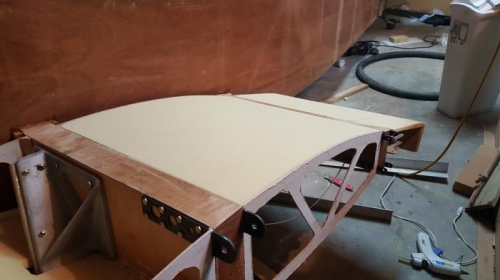

3/29 1 glued foam on left stub wing

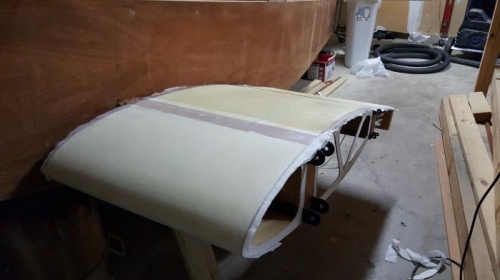

3/30 1.4 removed left gear leg, glued in lower leading edge foam and sanded to contour
3/31 1.1 sanded left upper stub wing to contour and floxed gear leg back on
4/1 5 finished sanding to contour then added fiberglass per the plans with the exception of an extra layer for the wing walk area

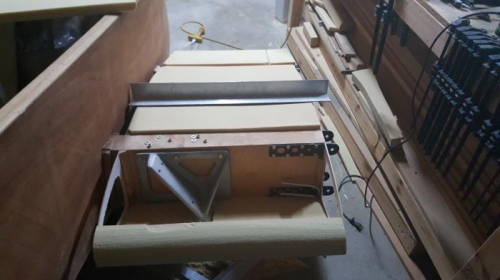

4/4 1.5 cut lightening holes on right side ribs and started cutting foam panels
4/9 1 cut/glued more panels for right stub wing
4/10 3 worked on right stub wing and started wiring dynon harness
