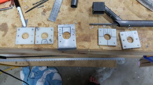

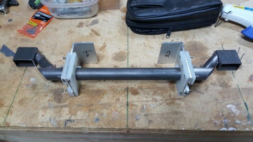

I fabricated the control stick mounts using 1/4" nylon blocks and aluminum angle. It took me three tries with the nylon but I am happy with the result.

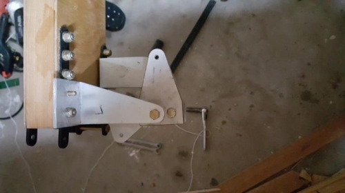

I deburred and primed all of the aileron control horn parts. I ended up swapping the lower brackets from left to right so I could place them higher up to fit inside the new airfoil contour. They were then drilled and bolted to the rear spar attachment fittings.
