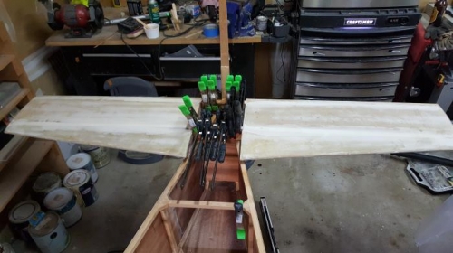

Brief Description:  Mounted horizontal stab
-Glued plywood skin at rear right of plane. The tail is now closed out.
-Glued in rear mount plywood/verticals for stab

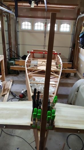

-Leveled aircraft fore and aft
-Ensured tail was centered
-Measured from foreward tips to main spars, a foreward center point, and the center of the stern post
-Incidence was set by adding a piece of 3/32" ply under the rear spar/set at -.75 degrees
-Glued in place with T-88 and then all measurements were verified again
-Varnished area below stab with thinned out T-88 before installing
I also glued in the upper brace to set the seat back angle. It is ready for the shelf to be installed.
