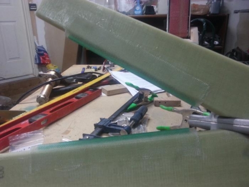

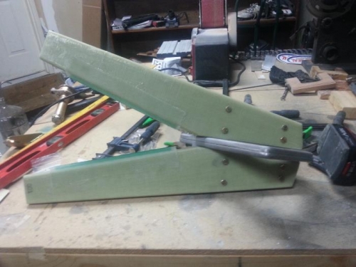

I got my landing gear from NvAero and started getting it ready for installation. I started by laying up the two layers of fiberglass provided onto the legs and then two more layers over a soda straw for a brake line passage. After it cured, I clamped the legs to the main casting and drilled the four mounting holes. They are ready to be mounted on the main spar.

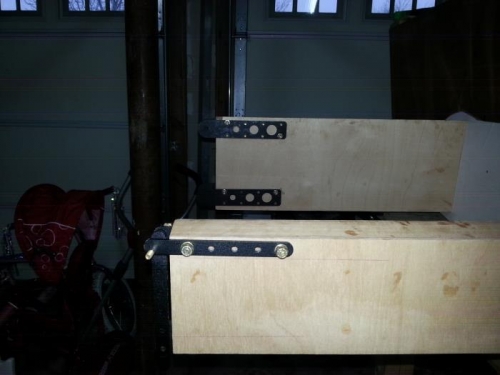

I also started drilling the center spars and installing the wing attachment fittings.
