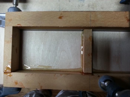

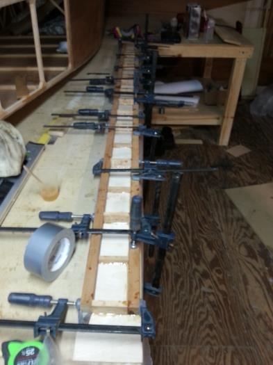

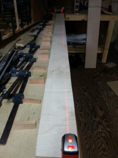

I glued the first portion of the rear center spar together. I started by dry clamping everything together and then drawing the outline on the plywood. I then checked the lines with my laser to ensure it was straight and square. Then one spar and all the verticals were glued using the other spar with duct tape on it to keep everything straight while clamped.
No lack of glue here!
