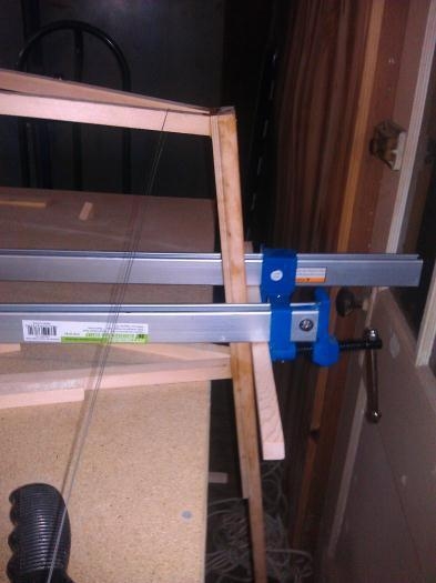

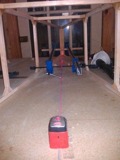

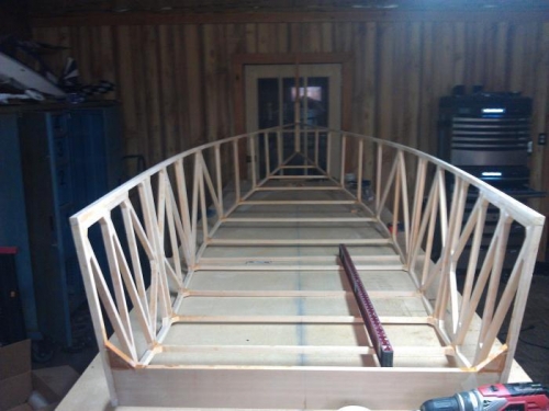

I glued in the stern post yesterday. A laser was used and projected down the center line to ensure it was perfectly vertical. I held it with a couple nails through the post and used the clamps just to apply pressure. Today I flipped the fuselage over to get my first look at it upright. I sanded all of the excess glue off and then cut all of the verticals for my center rear spar
