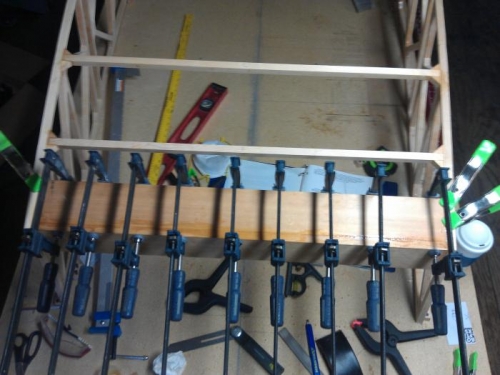

Brief Description:  Compression brace

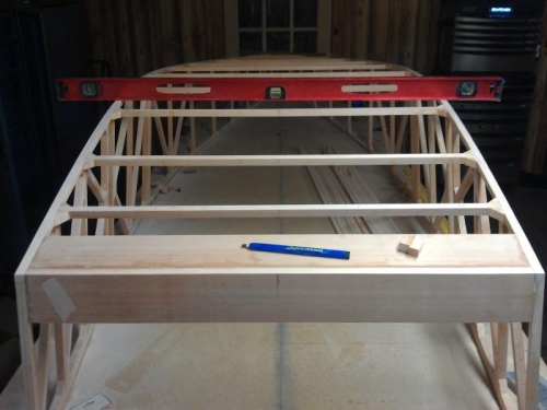

I glued in the lower compression brace yesterday and gave it a day to cure. Today I spray glued some 60 grit sand paper to my 48" level and spent a couple hours sanding the lower longerons to match the contour of the lower cross members. I followed it up with some finer sandpaper to smooth out the wood. The bottom is ready for the plywood to be glued on.
Compression brace clamped in
Sanding longerons
Sanding longerons
