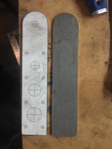

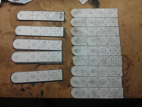

I managed to get 9 forward WAFs ground to shape today. I found it better to rough cut the steel to the outer dimensions and then glue the templates down. This kept them clean and preserved the edges so I could accurately trim them afterwards.
