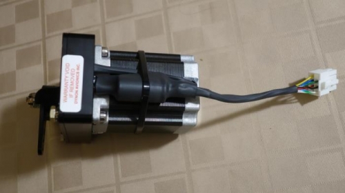

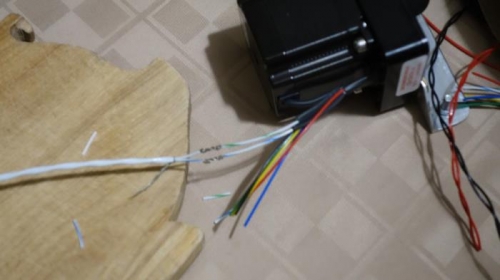

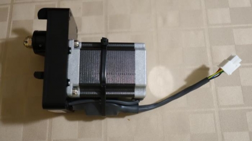

Brief Description:  Attached connector and cap to Aileron Servo
Crimped Molex Mini-Fit Jr. connector pins (Same connectors that Pipistrel provided, good for up to 9 amps. Ordered more pins and all sizes of connector blocks from Digi-key.) to connect to wire harness I am planning on building to route wires from instrument panel through to bagage compartment. Added heat shrink tubing and then pushed pins into 8 pin connector block
