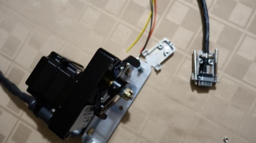

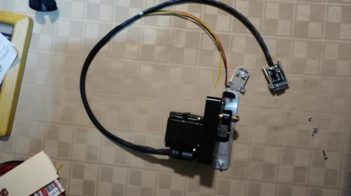

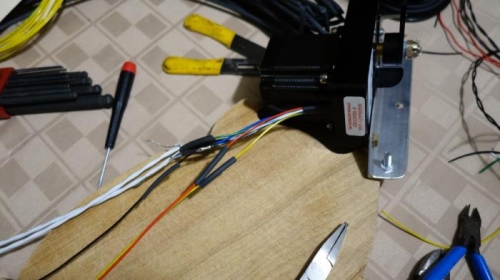

Added cap to Elevator Servo wire harness
Decided to add recommended cap to servo power to eliminate a possiblity of radio noise. Added recommended capacitor between power wires, re-covered with heat shrink tubing.
