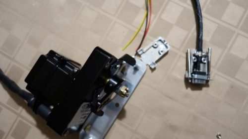

Date:  8-20-2018
Number of Hours:  4.00
Brief Description:  Manufactured Elevator Servo wire harness
Put heat shrink tubing on wires comming out of servo, crimped Molex Mini-Fit Jr. connector pins (Same connectors that Pipistrel provided, good for up to 9 amps. Ordered more pins and all sizes of connector blocks from Digi-key.) to wires and then pushed into connector block
