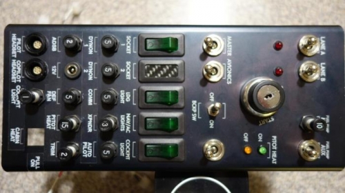

Brief Description:  Added Defoster Fan Breaker to electrical panel
Because I decided to added defroster fans after I had wired the electrical panel, I had to re-do some work on the panel. Added Breaker for defroster fan and 12v power jack for accessory power to the center electrical panel. Cut most zip ties, Used spare ground leads to connect to defroster fan power connector and 12v accessory power. Cut a new 3 gang bus bar and installed to get power to the new defroster breaker. Cut of .25 spade connector to socket switch/breaker and added 2nd wire for +12v DC power to power jack. Soldered wires to jack. Added 2 pole Jr. Mini Fit connector for power to defroster.
