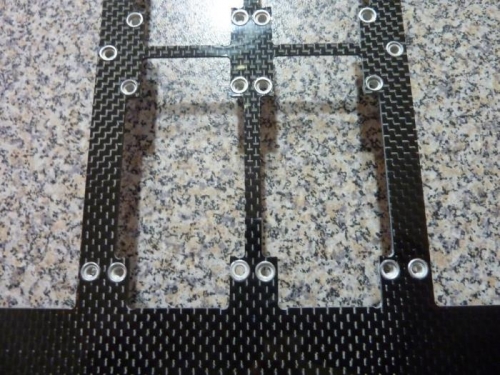

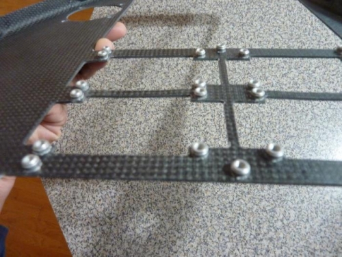

Brief Description:  Installed nutsert fittings on instrument panel
Nutserts were the only option I could make work with such small spaces between the instruments. They required the smallest hole and did expand when installed. Used my rivnut tool to install. Put a drop of super glue on each one to prevent from turning and to strengthen the very thin carbon fiber spacing between them. These worked very well.
