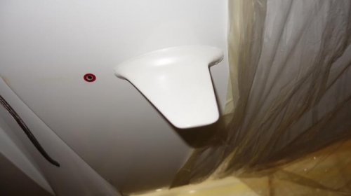

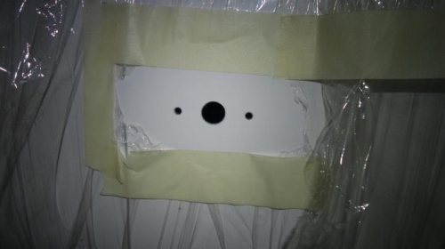

Brief Description:  Mounted ADSB and Transponder Antennas
Drilled Pipistrel pre-marked hole for the two high frequency blade antennas in the bottom of the airplane. Attached antennas. Still need to create ground plane. Carbon fiber is semi conductive so I don't know how much that helps the ground plane.
