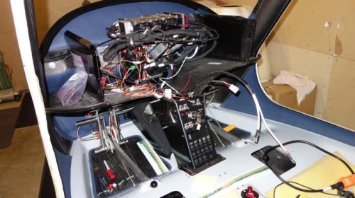

Date:  4-29-2017
Brief Description:  Installed Instrument panel base
Screwed on the instrument panel to the panel base and then positioned it properly in the cockpit. Use drill stops on my drill bits and drilled the mounting holes for the panel into the firewall, cockpit floor, and in the roof posts. Took out the panel base, removed the instrument panel and re-drilled the holes in the base to a to fit the black sheet metal screws provided (Longer screws in firewall to get through the firewall sound insulation). Re-installed the instrument panel base and attached it with the sheet metal screws.
