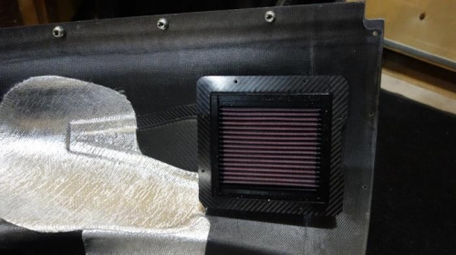

Date:  7-15-2017
Number of Hours:  2.50

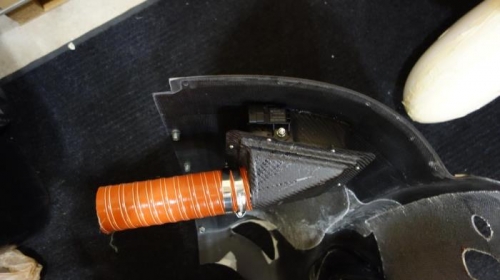

Brief Description:  Installed air filter and engine air inlet hose
Had to enlarge holes for screws, sanded off corners so they were not so sharp and also sanded both the air filter cover and filter holder on the firewall side so it would no pinch fuel line when cowl was installed. Inserted air filter and locktited on the cover screws
