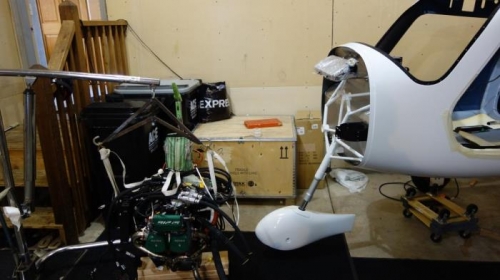

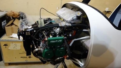

Brief Description:  Installed Engine
Tried installing with motor mount attached to plane but turned out to be too difficult to attach the motor mount bolts to the mount so I pulled the mount off the plane, mounted it to the motor, then mounted the motor mount and the motor together on the plane
